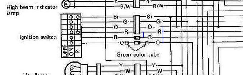

Does anyone know what the red and orange wires operate or connect to ? The two wires not connected to the green connector in the picture.

Red from 20A fuse, orange to light switch and pass switch.

For some reason the GT750 only used a four wire system, this means ALL the power passing through the ignition switch crosses two little square contacts on the switch plate thereby joining the red to the orange wire inside the switch for "on".
The brown wire is park and the grey wire is the instrument lights on all the switches, turned on inside the ignition switch, taking power from the red terminal contact, according to how the switch is turned. The 380 and 550 have a pair of switched contacts, hence two reds and two oranges along with the brown and grey wires.
I had mentioned this in the electrical section where I altered the 750 harness to use the 380/550 switch with a pair of separate switched contacts as well. In my system one set of the paired contacts is running the light circuit and the other set is running the ignition and charging circuit.
The reason for all of this is to spread the load from the battery between the switched contacts so they don't become overloaded.

The earlier drawing was the 550 - seeing the 6 wire switch, I assumed that was what it was for, this one is the 750.

The single plug 4 wire switch can be used on any if the GT's. In the case of the 550 and 380, the orange and red wires must be externally connected as they no longer run through the switch like the 6 wire switch. Indicated by the blue lines in this illustration.
