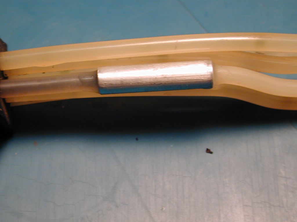

Have a single broken line on my Gt 380. Removed all the lines so I could get to it. Break is half way thru and is the only place it leaks.. Any suggestions on epoxy to repair it. The check valves all work. Have a spare but its not in as good of shape as mine (except for the one crack).

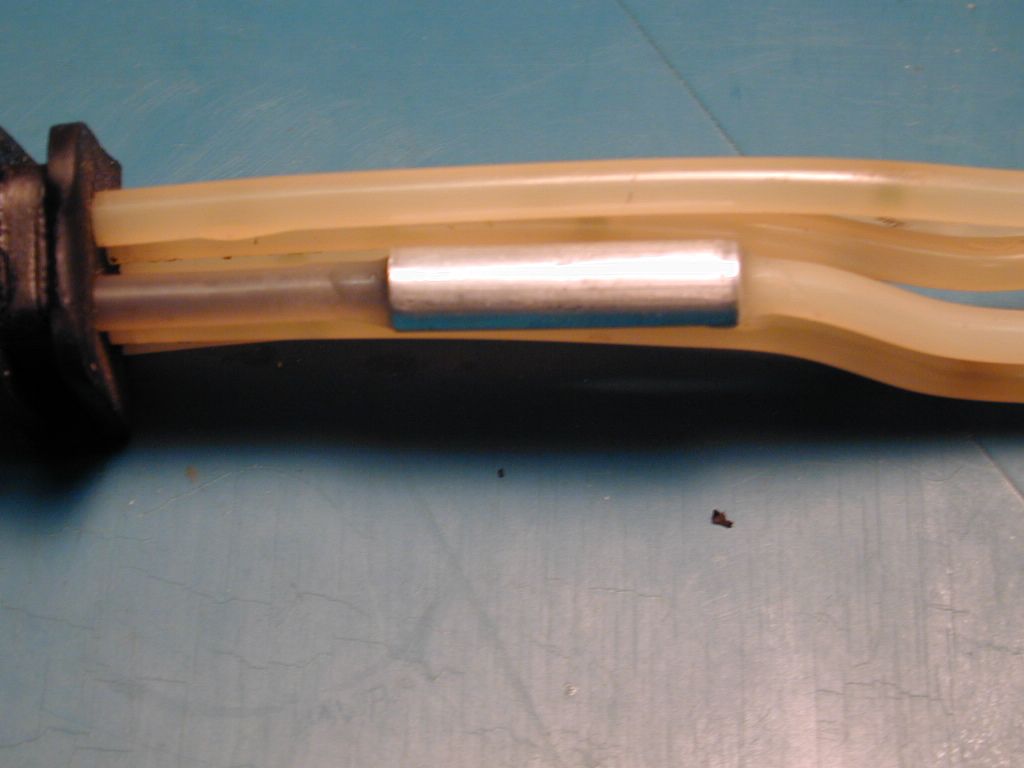

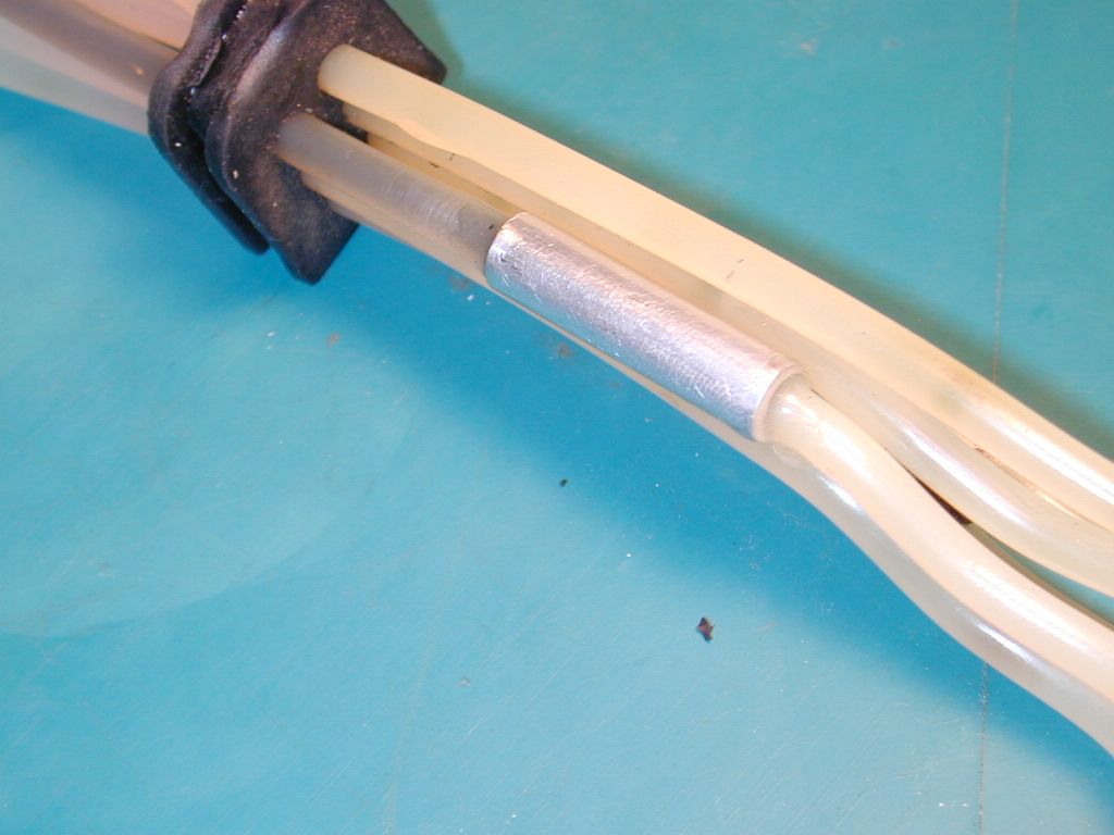

Re: Broken oil line
These pics? Not brass. Started life as a 1" long section of 1/4" aluminum rod from the hardware store (had to buy 3'). Drilled through to the line ID. counter drilled 7/16 from each end to the line OD. Roughed up the line surface for 'tooth'. Used standard 15 minute epoxy applied to the line OD only so that none would squeegee into the through hole.

Coyote wrote:These pics?
Yep - those ones - thanks again for the idea Chris. So far its working well ! 8)
