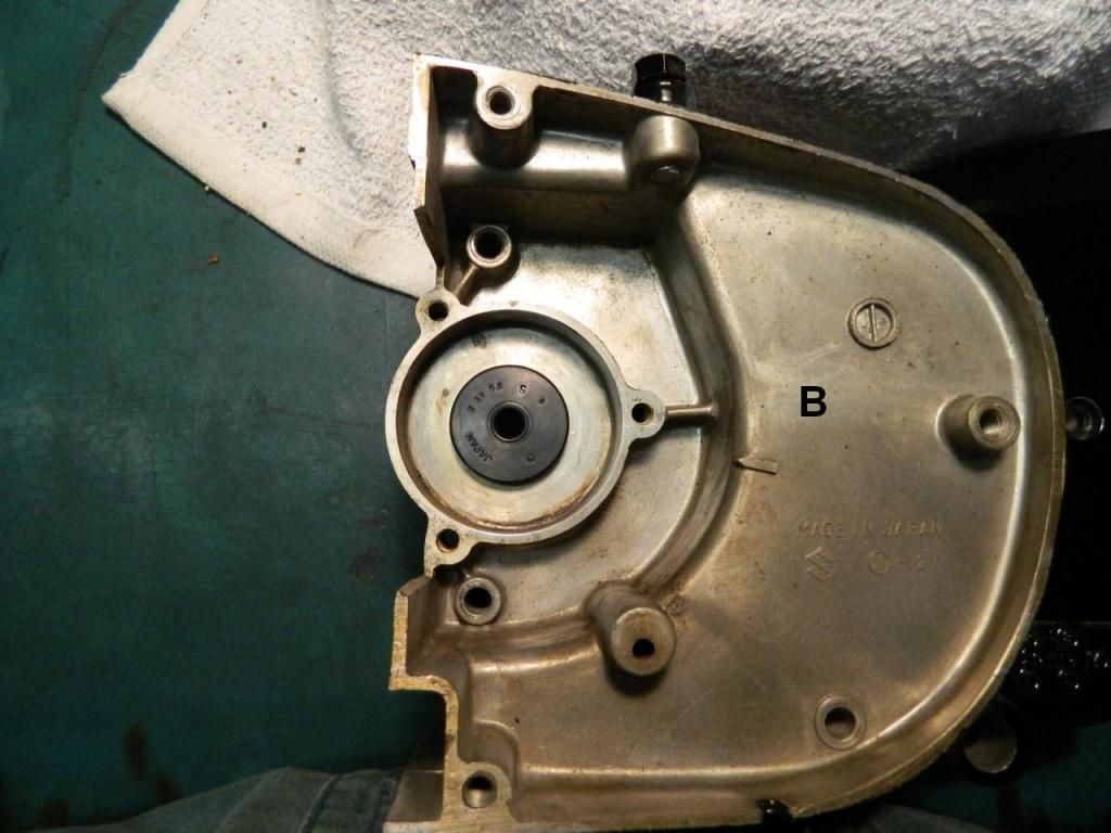

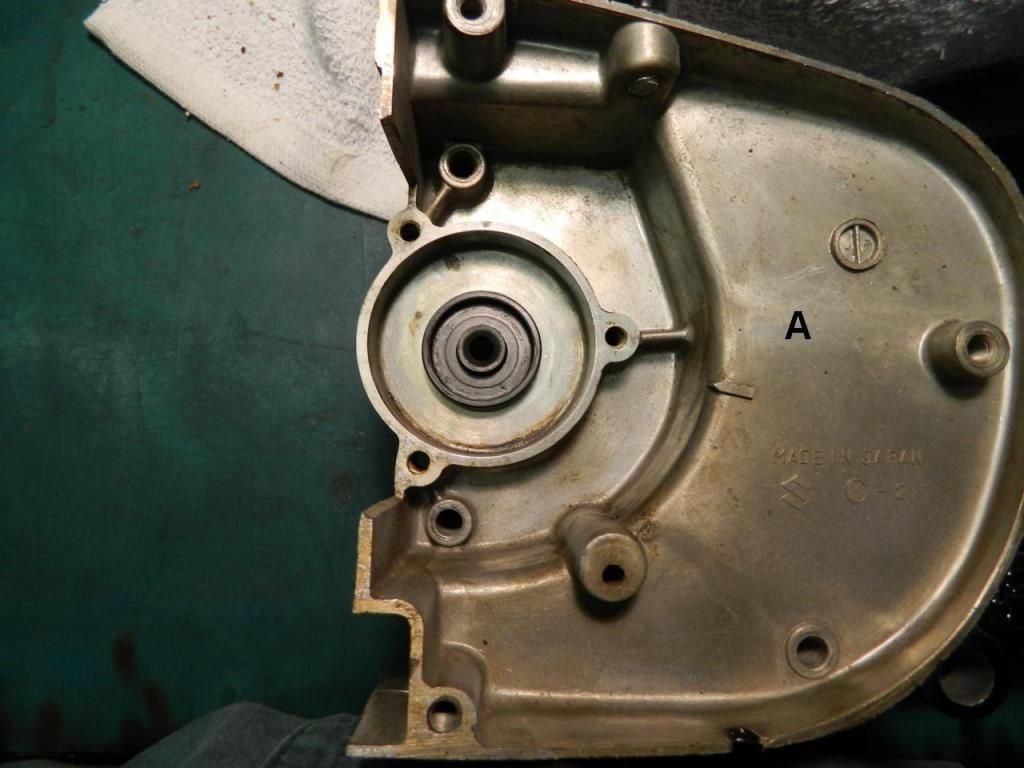

A or B? I thought I would remember :?

Checked three of the ones I have here and they're all picture "A"! Flat side to the inside.

Just did it. Second the A for sure..

oil seal 09285-08004 cup faces in.
Dust seal 09285-08001 cup faces out.

I'm not sure that's correct. The seal ending in 08004 has the cup facing into the case. The seal ending in 08001 has the cup facing in also?? This is a separate cover from the case . The cup faces the gasket or the actuating arm. Maybe that's what you mean. Just depends how I'm reading it??
