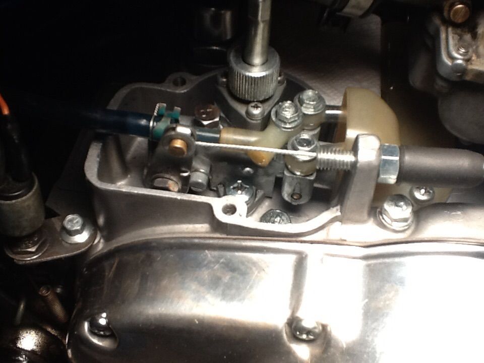

Picture 1 - The oil tank breather hole did have an OEM looking / fitting rubber cap on it, which I do not see in the parts book, which makes me think it is either a PO Mod or a limited edition piece worth hundreds of dollars, if anyone wants it, let me know.
Picture 2 - the throttle lever at rest, their is a line that matches up with the pump line, I had not noticed this earlier.
Picture 3 - the throttle is wide open and the adjustment line is now dead on with the line on the pump.
