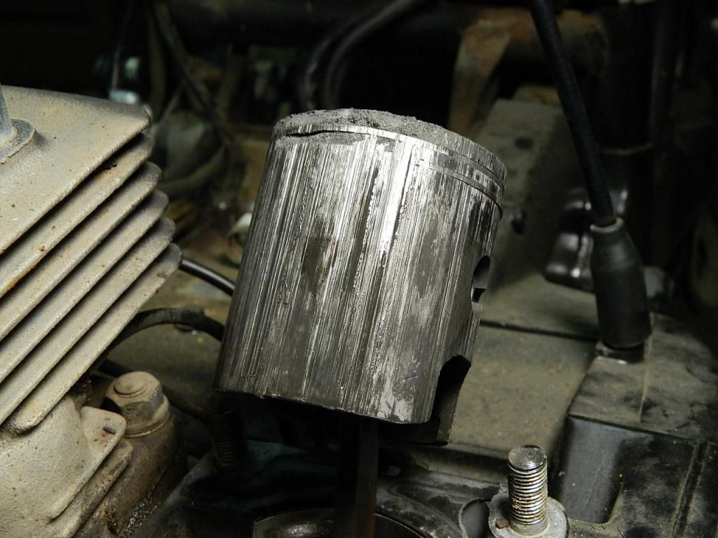

I asked this same question about starting up my GT550. That should be tomorrow!! I have decided to run 64 / 1 premix for start up BUT, that fuel will be in a separate tank hanging from a tripod standing along side the bike. As soon as the oil pump proves out, it will instantly be switched to straight non ethanol fuel -- in the bike tank.
For the accessory start up tank, I just adapted a hose barb to an old plastic Simple Green jug. I even put a shut off valve on the start up tank so I can shut it off and burn up the remaining oiled down fuel. Whatever is left over will go in my chain saw supply can.
I have reason to be skeptical of the oil pump as this motor had a totally fried left piston. Some of you might remember the pic. I don't need that again. Some minor scuffing :shock:

Wow that looks like a hoone doesn't do it.. i will make a aux tank with light premix for initial startup, then run straight petrol when i hit the road.. I believe that craigs suggestion is close to what i have heard, and also close to what i did last time... Thanks for all your advices.. I will use some blendzall 455 ultra, it works as injector oil and is with castor... either that or castrol tts.. like that one too.

@Coyote - wow, that is one SHOT piston. It's even crumbling away between the ring grooves :shock:
Re: GT750 breaking in, any recommendations?
I gave the piston to the owner of a local bike shop, to put on his counter as a conversation piece. I think he tossed it because I've been back there and haven't seen it.. As you can well imagine, the cylinder was shot too. I didn't think there was anything serious wrong with the bike. Then I ran a compression check :shock: :(
