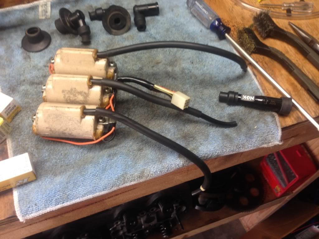

Went and bought new spark plug caps. I trimmed a bit off the end of each lead to expose some clean wires and rigged em all up.
Hasn't seemed to make any difference though, I'm still only getting the left cylinder to fire.

For a quick test of the coils, run temporary wires at points to change which coil connects to each of the points. Switch plug wires around accordingly. If its the coils a different cylinder will fire.

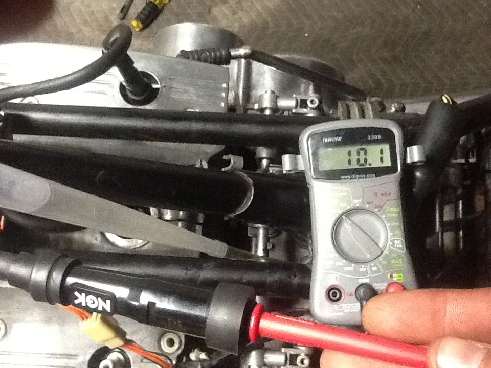

I used my voltmeter and each spark plug wire was getting 10.1 volts, my battery is getting tired from so many failed attempts to start so it is now down to 11.9 volts. But if I am getting voltage at each coil then why wouldn't it be getting spark?

Re: GT550 budget build
Where you need to test voltage is at the wiring harness connection to the coils .. the orange wires as the are the + connection when the key is on . while testing your bike you can leave the charger hooked up , just disconnect when the engine is running . When you are cranking the engine you can put several fingers over the mouth of the carb , you should feel a equal draw .. this can also be done when the bike starts but not on one cylinder , put several fingers over the carb mouth and it will draw extra fuel and may start running if you are getting spark .

Suzukidave wrote:Where you need to test voltage is at the wiring harness connection to the coils .. the orange wires as the are the + connection when the key is on . while testing your bike you can leave the charger hooked up , just disconnect when the engine is running .
Okay, I did this at the harness and got the same reading 10.1 volts for each orange wire. Battery is still at 11.9.

Suzukidave wrote:Try the timing light test i suggested on each coil wire while cranking the engine .. getting no flash .. you are getting no spark
Did this and I get light when I connect the test light to the orange wires at the harness, but not when I connect them to the spark plug wires.
