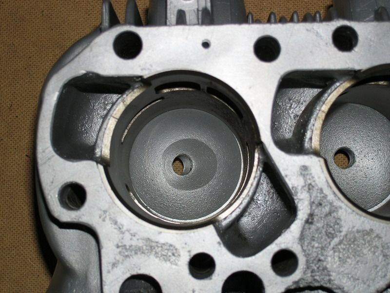

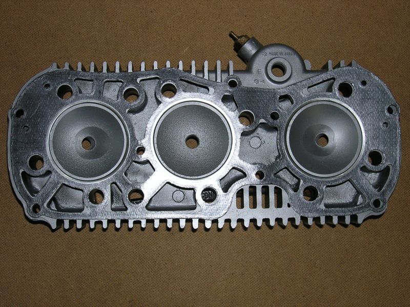

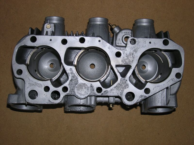

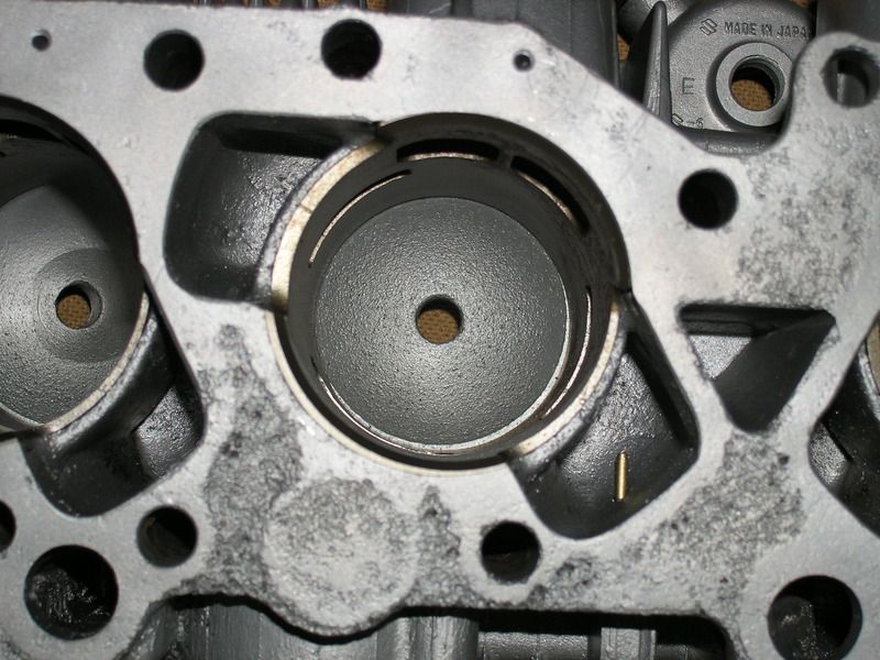

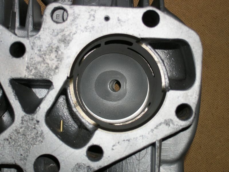

Finally..........
Looks like the answer is...not very well at all
Re: Holy Cylinder Block!
I feared the machine shop didnt do you a favor boreing the cylinders so far off center :?

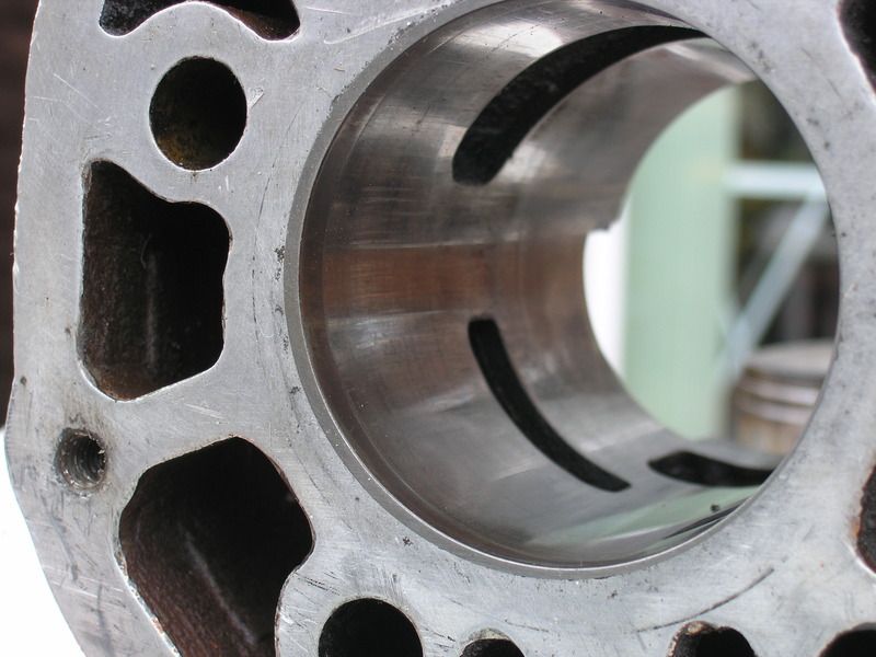

'Found this pic of the block before the rebore.....check out the lopsided sleeve.
I can't nderstand how I missed it :roll:
Wow !! i need to take back blaming the machine shop as it sure looks like it all started right at Suzuki mfg :oops:
