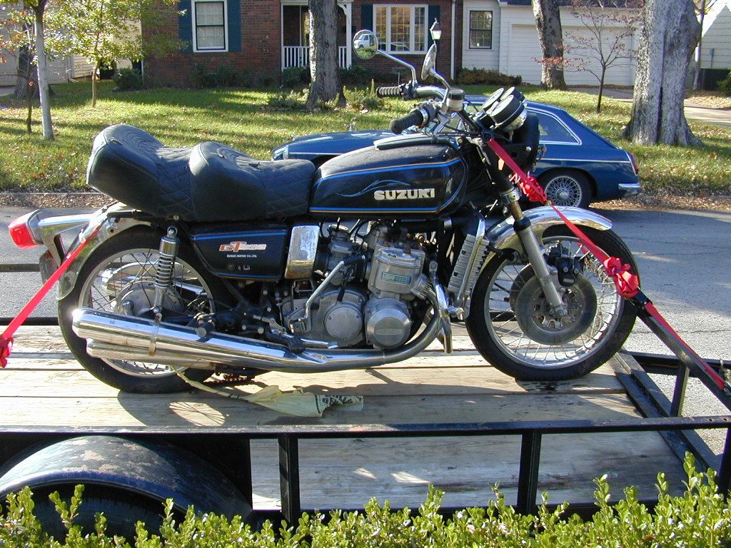

Well, I got to work on the Motorcycle some more today and here are the updates.
1. I forgot to mention earlier that it doesn't have a fan, but has the mounts. I see other GT750s are the same. Mine is a 1975, so should it have a fan or not?
2. I got to the oil pump and the lines, do I have to remove the starter to get the lines off of the block?
3. The Piston all the way on the left (if your sitting on the bike) has a shiny ring in the middle, the rest of the piston has carbon on it. Almost looks like it was machined there. Should I be concerned about this?
Thanks for any help you can give me.

:) 1. Your bike was not fitted with a fan from new,this was dispensed with by Suzuki fairly early into the production of the K model in most markets around the world,but you could at one stage buy the fan if you wanted one as a spare part.
2.If you want to make it easy to take of the lines,yes remove starter motor,you'll also have to remove the water bypass hose connector to allow you to slide the starter motor from position,what ever you do "DON'T" use compressed air on the oil lines to clean/check them internally!!!
3. That shiny ring in the centre of the left piston could be a "hot spot" caused by the wrong heat range plug,or that cylinder running lean,could be about too burn a hole through the top of the piston!!
investigate the cause....As soon as possible :cry:

GT750Battleship wrote: :) 1. Your bike was not fitted with a fan from new,this was dispensed with by Suzuki fairly early into the production of the K model in most markets around the world,but you could at one stage buy the fan if you wanted one as a spare part.
Hey Battleship,
I figured that is what caused the "ring" with the piston. I will check out the carbs to see if they caused that cylinder to be lean. The ring on the piston top isn't very deep at all, how deep should it be before I am concerned?
Thanks for you help
Re: I found a GT750 yesterday on Craigslist
:( Be very concerned,do not put the bike back together until you have this sorted with the piston!!
What grade plugs are you running should be NGK7ES or 8ES depending on the model you have?
They can HOLE a piston real quick,check the carbs by all means...but the plugs are the main suspects,wrong heat range etc....lack of oil delivery is not good...I'll go back & read your earlier posts to get some back ground on what you've done so far..
