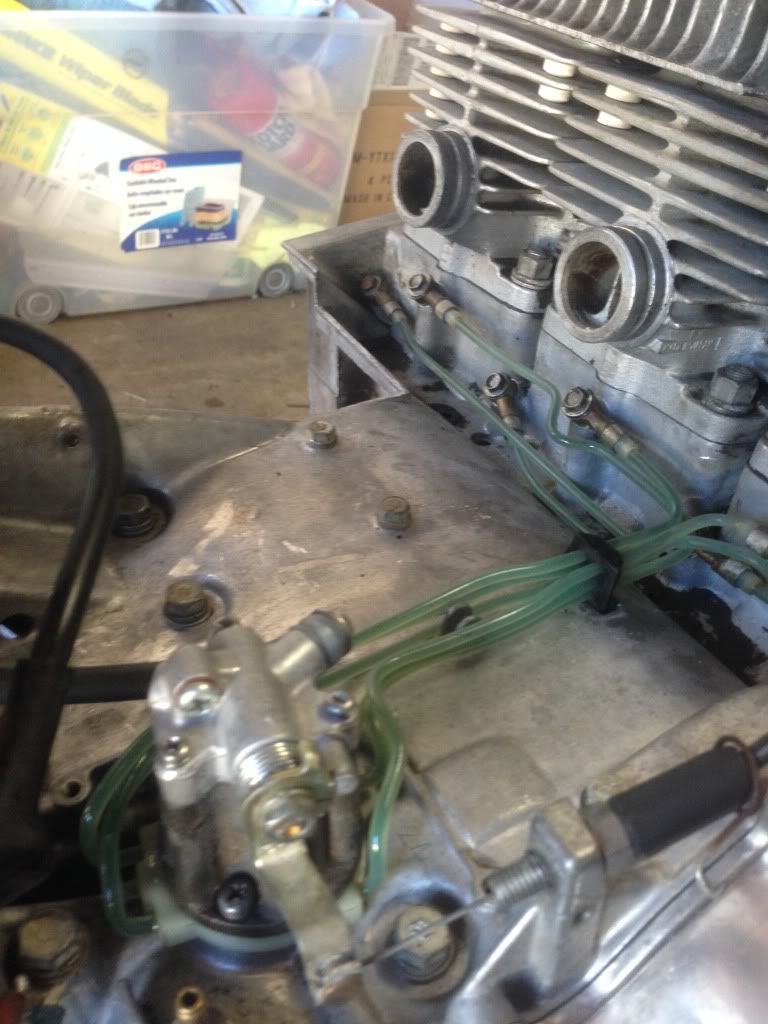

I moved on to the oil pump. I primed all the lines as described in another thread here. Bled out whatever was left over inside them. I like the look of the blue oil in the lines.

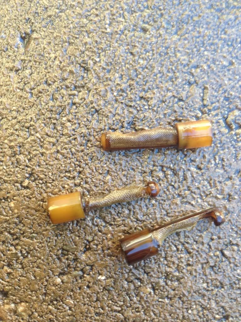

So I got the other two screens out with a little finesse.. One looks "ok" but the other two aren't so good. Since Coyote informed me that the whole SRIS system can be eliminated anyway, can I just reuse these screens even though two are ripped?

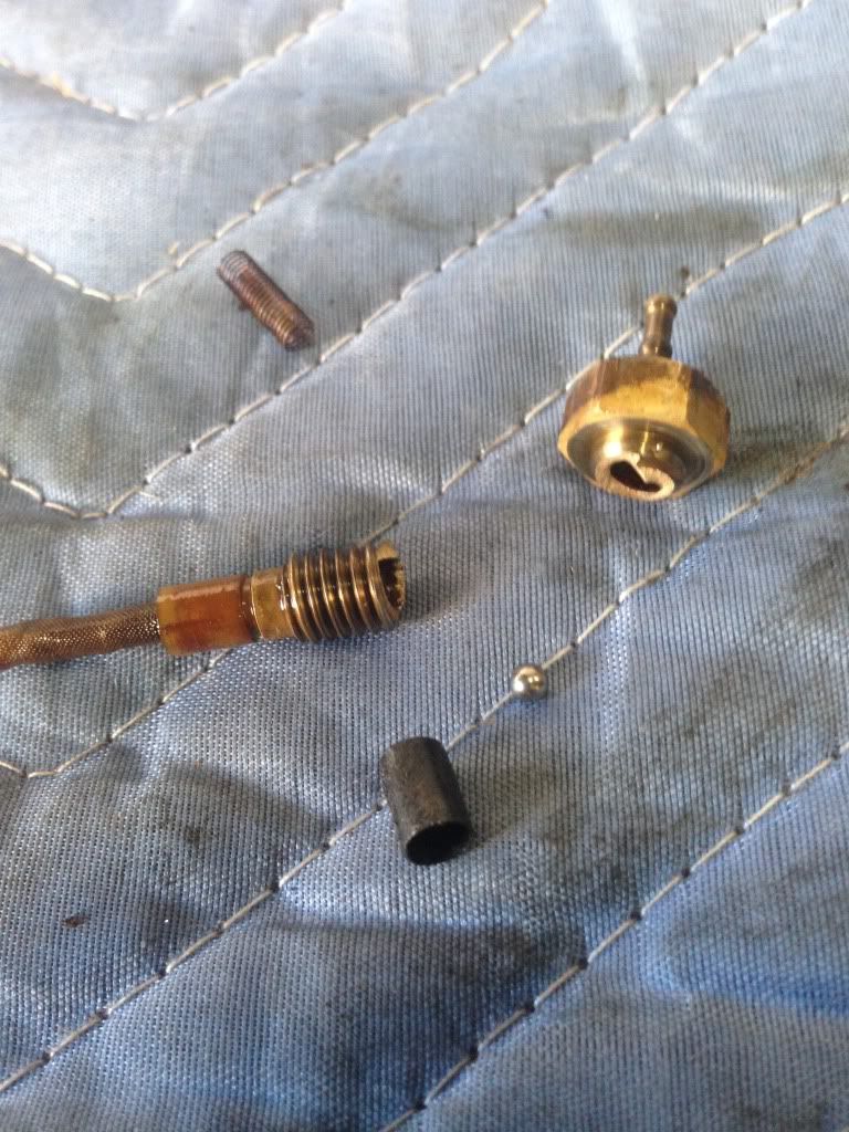

Wonderful, now this happened, hardly even tightened it down and felt it break..

Suzuki part number 16710-31012 SRIS check valve. $16 each...

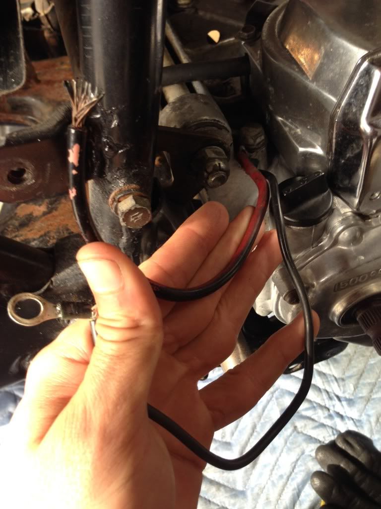

Does anyone know where these two wires go? Are they for the oil pump? I'm not sure what to do with these..
