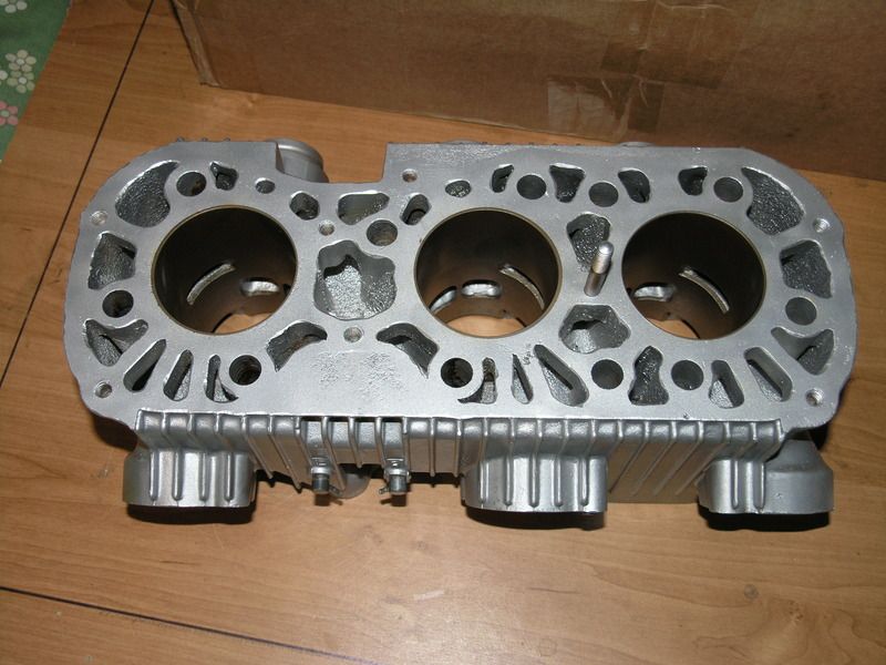

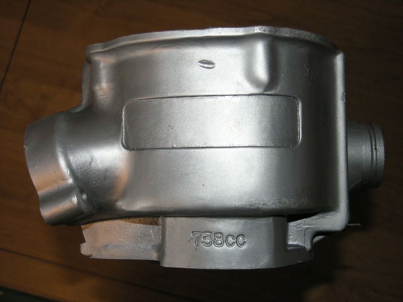

Couple of things.
First off, most people do not use a mill to bore a cylinder. It has been done, but the correct way is to use a special boring machine and it is usually centered on the existing bore. http://www.ebay.com/itm/Kwik-Way-FL-AC- ... 2490730206" onclick="window.open(this.href);return false;" onclick="window.open(this.href);return false;
Bores on GT750 blocks are usually off from where we would expect them to be - stock. And boring say 1mm o/s if it was way out of place could only be at most 1mm out of place in an extreme situation, so that is not the main issue here.
Unlike some motors, say Honda for example, where the cylinder block is machined and then the liner is pressed into place, a GT750 liner is cast in place and that is not as accurate for placement. That, I believe, is why GT750 liners are always off and some are worse than others.
In addition, it would appear that heads and barrels are not machined consistently and some are a worse mismatch than others. In the majority of cases, head gaskets are a poor fit with bolt holes frequently out of place and they are grossly oversized for the bore.
If you found a replacement block, it would be interesting to bore those cylinders 1mm and 2mm oversized to see when the boring bar starts to break through.

Re: Holy Cylinder Block!
I was thinking the same thing...well almost. I would like to cut them down the centre
I'm still not sure if the thickness of the sleeve showing at the top of the cylinder is the same all the way down. I seem to remember reading that sleeves are "finished" at the top in some way, at least when they are replaced by pressing into the cylinder. I'm not sure what this entails, I may take the block to a well known borer in the UK that makes new sleeves. I notice LA Sleeve in The States sell replacement sleeves for the GT so presumedly they can be replaced?

- Posts: 6213
There is a cross section in the FSM that shows the section shape. It's the picture of where to measure wear.
Liners are thinnest at the very top.
tz375 wrote:There is a cross section in the FSM that shows the section shape. It's the picture of where to measure wear.
Ah great...thanks, I'll have a look
What's your thoughts about the feasability of fitting new sleeves? I know it's not going to help much with my block, 'just curious.
Suzukidave wrote:Do you have a Facebook account ? there are a bunch of nice GTers living in the UK that are on this site maybe they can help ya out locating a cylinder block in good shape https://www.facebook.com/groups/26261717446/" onclick="window.open(this.href);return false;" onclick="window.open(this.href);return false;" onclick="window.open(this.href);return false;" onclick="window.open(this.href);return false;
Big thanks for this tip Dave...one of the guys on there pointed out a respectable looking block with meaty sleeves in the US, ('sure I checked there

- Posts: 6213
It is an excellent way forwards because it allows you to fit custom nicasil plated (after fitting) aluminium sleeves ported to your own specs. While the thick iron liners are out you can also take the time to weld up the edges of the transfer ports so they can be ported even wider and you could even add an exhaust bridge and additional transfer ports, auxiliary exhaust ports and put a shaped divider in the transfers. And you could add material to the top corners of the exhaust ports so you don't break through when you raise them and square them up.Drewski wrote: .....What's your thoughts about the feasability of fitting new sleeves? I know it's not going to help much with my block, 'just curious.
All for the same price as a new bike or so I would guess.

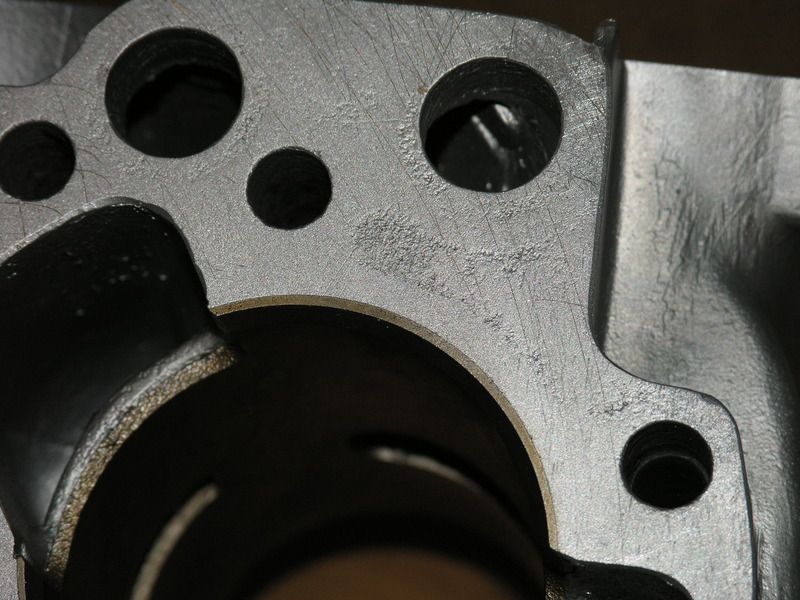

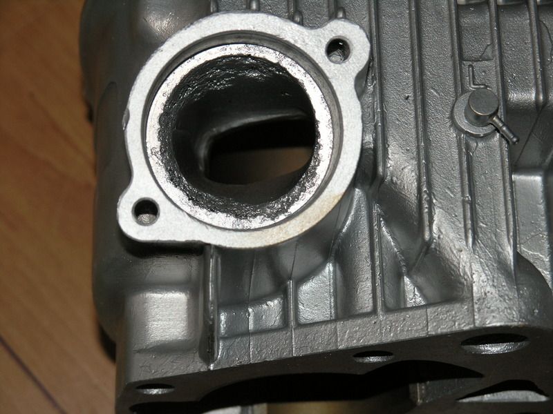

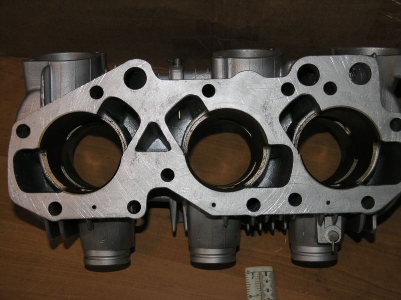

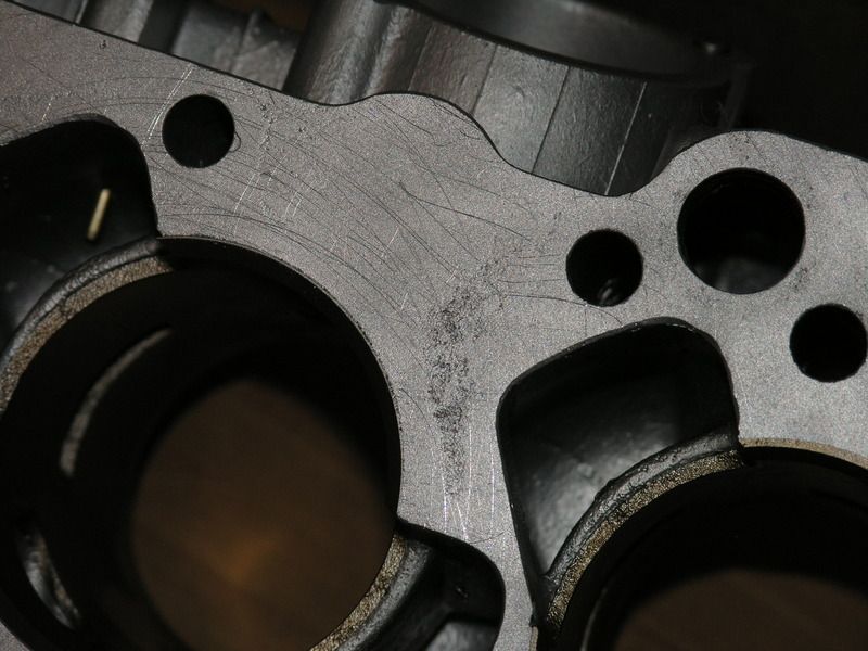

That rot is all your own fault for cleaning it properly and looking....
You can safely skim say 10 thou off both lower and upper surfaces to clean them up a little and a decent (Cometic) gasket will seal the rest. That exhaust is a bit gnarly, but should be OK. I suppose you could have that welded up and then dress it back, but I doubt it is necessary. Even stock, they are not a perfect fit.
One might argue that the exhaust gasket (O ring) is not designed to take full on flame impingement, but I think you will be OK.
I would say as long as the sealing areas around the bore , water jacket and transfer areas are clear of surface problems you would be ok to use as is . The exhaust port i would clean up a bit just so the carbon will not build up on the rough surface so fast and that could be done easy with a bir or sanding drum .
