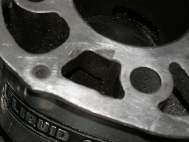

Where the rot is, there was some hardened on lumps of oily coke. Strange, as the rest of the block seemed really clean.
It definitely looks like it's from before the 1975 port modification. When Suzuki did this, I presume they just lowered the floor on the ports........... or did they move them and keep them the same length/height?

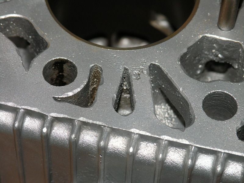

So I took the block to my local reborers yesterday to see about honing the cylinders and skimming the top and bottom. He wants me to get the hole built up first. He says that he works on a lot of Triumph Stag alloy heads and pitting like this can cause problems.
I've found a local welder that comes to you and going by what he said it's going to cost about £220 GBP, $300 US, so I'm going to see if it's something a mate of mine at a nearby bike workshop can do, he can weld wood to glass.
Offending hole:-
Offending hole:-
Re: Holy Cylinder Block!
For my .02 opinion that fault is all in the water jacket area and would not cause a problem . As long as there is clear metal around the cylinder bore , the outside edge of the block and around the stud and bolt openings you would be good for a skim . I bet a product like JB weld would fill those faults well enough without the need for welding .

I was looking at it that way myself but it would probably blow eventualy, and I'd only end up having to sort it then. Head gaskets aren't cheap eitherSuzukidave wrote:For my .02 opinion that fault is all in the water jacket area and would not cause a problem .
As there's a surprising amount of meat on the barrels, and the sleeves all look nice and central, it's worth sticking with this block.

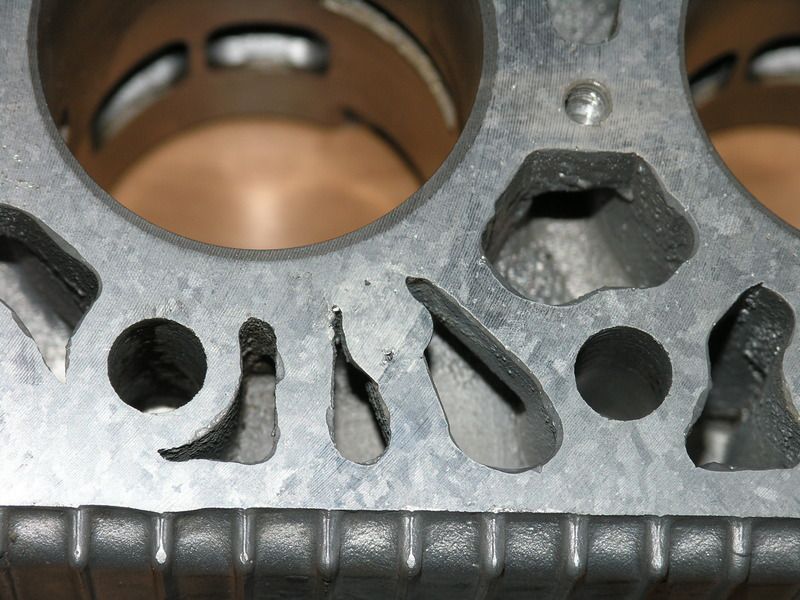

Just for the test .. did you happen to put on the head with this new block just to see how well they line up

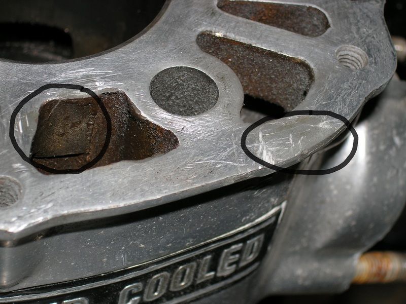

I have used the above on a honda 400 race engine,It worked for me.
On stripping the engine i saw deep gouging where i take it someone had been scraping the old gasket off.
If it were me i would skim the top first, then fill whats left and flat back with wet or dry paper.
