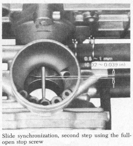

It sounds to me like your carb slides are not topping out like they should. With the engine off and airbox removed, look through the throat of the carb and pull the throttle wide open. No part of the slide should be below the full circumference of the hole of the bore. When properly adjusted, at wide open throttle the slide should be 1mm above the carb throat.

But if there is plenty more throttle to be had when the problem arises (approx 1/4 - 1/2 more available in my case) that means the slide hasn't fully opened but the issue still occurs. I could see how if the slides are topping out prematurely it could cause this problem, but since there is more slide movement available I don't think this is where the problem lies, at least in my case. Still going to check this though. Maybe this is the case for Glyn.G?
Glyn.G - When you experience this problem are you at wide open throttle or do you still have more throttle to play with when it happens?

Well I've just changed back to original jets and needles to double check. The carb slides are opening fully and floats seem to be at the correct height, yet made no difference at all.
