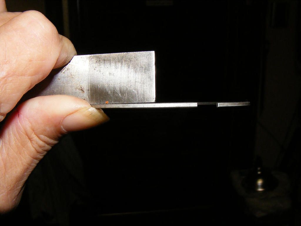

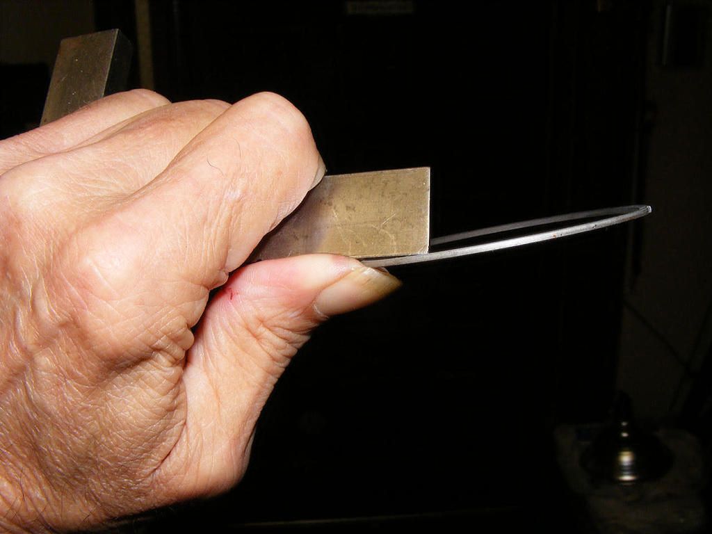

All the books say the tapered side is marked. I have gone through 18 of these rings now and no a single one had any marks. So it's up to us to determine which side is which. . There are many different way to do this, but I have found the simplest way - especially if you have old worn out eyes like mine. All that is required is a straight edge and a thumb. So you can put away your magnifying glass, your sheet if glass, your surface plate etc. The pics are self explanatory. Cool huh?

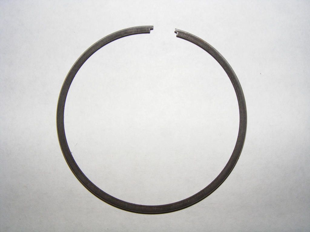

These are genuine Suzuki rings and they definitely are keystone type rings. Obviously tapered on one side. There are no marks on them. I even looked them over with a jeweler's loupe. The last 6 I got from Paul Miller also had no marks at all. And the 6 in RedZone -- no marks. I guess you got lucky.
Re: Keystone Rings
Mike. One ring at random from box of 6. Tapered side up -- no marks

That looks like a .50, (20 thou) adjacent to the right side of the gap, and marks should be on the top side of the ring.

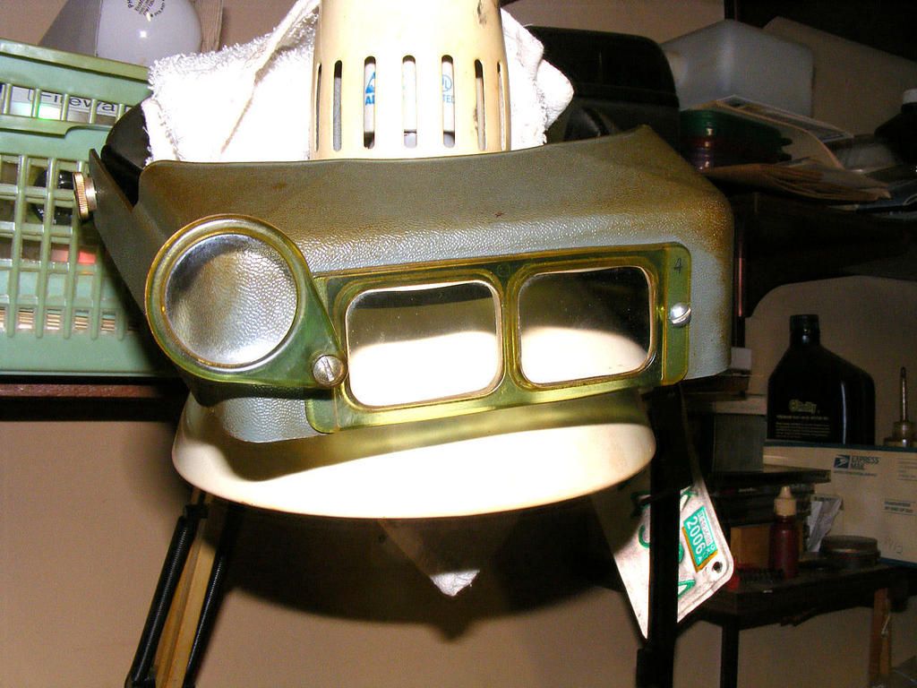

What are you smoking Alan? I don't see it even under strong light and heavy magnification. I have these. You can see gnats fornicating with these.
http://www.amazon.com/Jewelry-Displays- ... r+headband" onclick="window.open(this.href);return false;
Re: Keystone Rings
Mine even has an accessory flip down super mag. With my reading glasses on and the Opti-Visor and that third lens down, the focal length is about 12mm. I still don't see any numbers
I've had my Opti-Visor for many many years. Very handy when needed.

specsavers comes to mind, if you zoom in on the photo you have put up, just to the right of the gap in the ring you can clearly see .50
Re: Keystone Rings
I'm not joking, but I saw a '50' marking to the right of the ring gap in that pic, before I read Alan's post.

cutout from your picture, added some brightness, contrast and sharpness
Re: Keystone Rings
I stand corrected. No wonder I'm scheduled for cataract surgery on the 22nd. Should they all be marked in the same location?
Re: Keystone Rings
I answered my own question. I took pics of all 6 and blew them up one at a time. All are marked .50 as well they should be. The ring box was opened and I wanted to be sure there were no mix-ups. My hat goes off to the guys that could see this with the naked eye,

The funniest part of all this isn't the missing of the '50' (though it is as described and yes it is on top side)
Has no one seen the 'T' clearly stamped top side on the other end of the ring? you're all winding me up :-)
