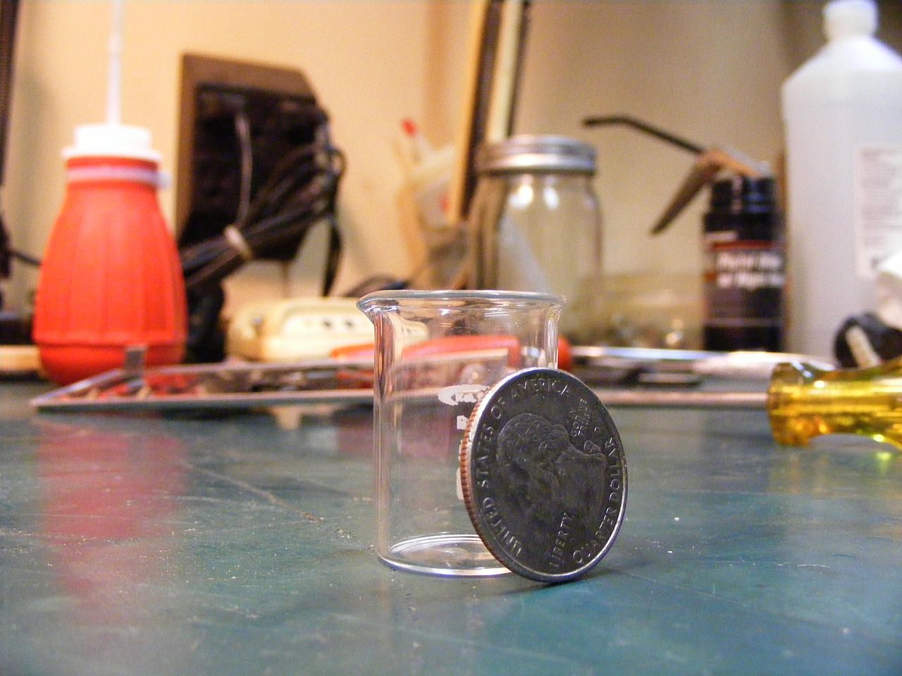

The beakers showed up. They are almost too nice to use for the intended purpose. Should be displayed somewhere, but I have no place. This is the smallest of the bunch. 5ml. That's either a tiny beaker or a very large quarter. You decide.
