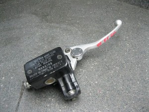

actually, you've made me remember, the master cylinder I fitted was from an early 90s Suzuki RF600, which explains why it was so cheap. However, I am fairly certain that the same part was used on the 1990s Bandits too.
I cannot remember what the piston diameter was, unfortunately. All I can tell you is that it worked perfectly with the standard GT380 caliper, improving the stopping power while needing less effort at the lever. I fitted it because the plastic reservoir on the original master cylinder started leaking.
It was exactly like this:

Looks like the one on the DD GT550 that's nearing completion.
I can't remember the piston diameter either, but if someone wants to do a search for refurb kits and post the info, then we'll all know........

Thanks Craig,
I due course I may check out the part number and confirm what other bikes that m/cyl was fitted to. Shame it had no mirror thread as far as I can see.
- Posts: 3257
Re: GT 380/550
If you get a 'new' master cylinder from a bike with fairing, it doesn't usually have mirror perches as mirrors are on the fairing, but naked bikes do as they don't have anywhere else to fasten mirrors.
