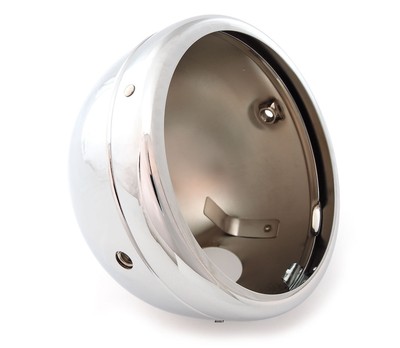

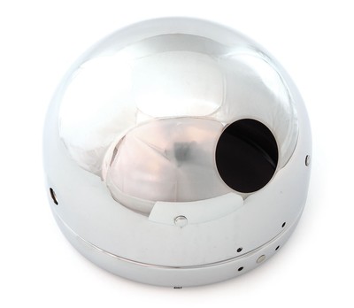

Emgo 66-65073 - 5 3/4" chrome shell. Standard size light should fit. Just don't go too high wattage, without upgrading electrical system some.
I have the 7" model on my T500. Looks period correct, and have a much brighter headlight now, too.
