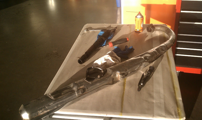

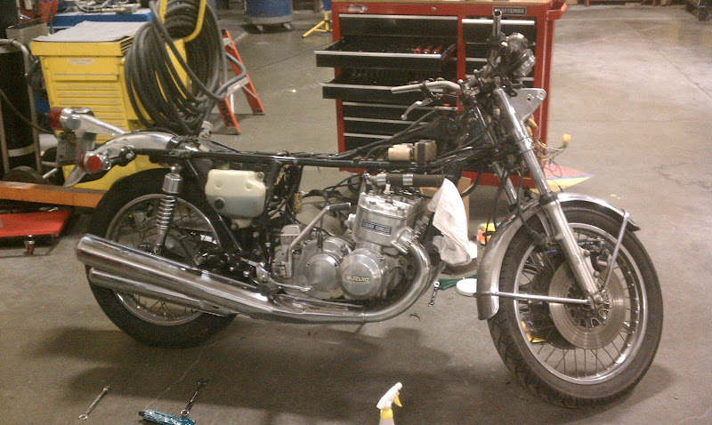

Got some work done on the exhaust and air filter over the last few days. Mostly just cleaning. Some nice evening sun and blue grass courtesy of the Steeldrivers make for a great work atmosphere.
I did have a few questions for people out there. Can someone explain the fiber wrapped at the end of the baffle? Purpose? Looks like it is held together by safety-wire. Not sure if that's Mr. Suzuki work or the previous owner.
Tonight I was able to install the original 3-4 exhaust on the bike and it looks pretty good! How loose should the exhaust be? When I grab the small exhausts and give them a little wiggle, there's some movement... not a lot. All the bolts are snugged, just not sure if I'm missing something seeing that I'm re-assembling something I didn't take apart. It may be designed to have a little give to absorb some vibration... not sure.
Re: Restoring a '75 GT750!
Baffles and loose lowers are normal. The stuff around the ends you are referring to is used for baffling the sound and yes it is held together by wire from the factory. Yours however, is slowly coming apart. No big deal. Just rewire it. All lowers on these bikes jiggle a little do to flimsy mounting tabs. Especially when the bike is started.

As PJ mentioned, stock baffles are wrapped in fiberglass wadding and it's held in place with safety wire. It's designed to absorb some of the noise not attenuated by the mechanical baffle. You can but replacement two stroke wrap/baffle material from a dealer or on-line. One pack will be more than enough for all 4 baffle tubes. Some guys run their baffles without thjat material, but I prefer to keep it.
The engine is rubber mounted and so are the exhausts. Side pipes are one piece, so they don't move much, but the centers slide over the header pipe with rubber sleeves and that arrangement allows a small amount of play. The outers should not be solid though. There should be a small amount of wriggle room.
