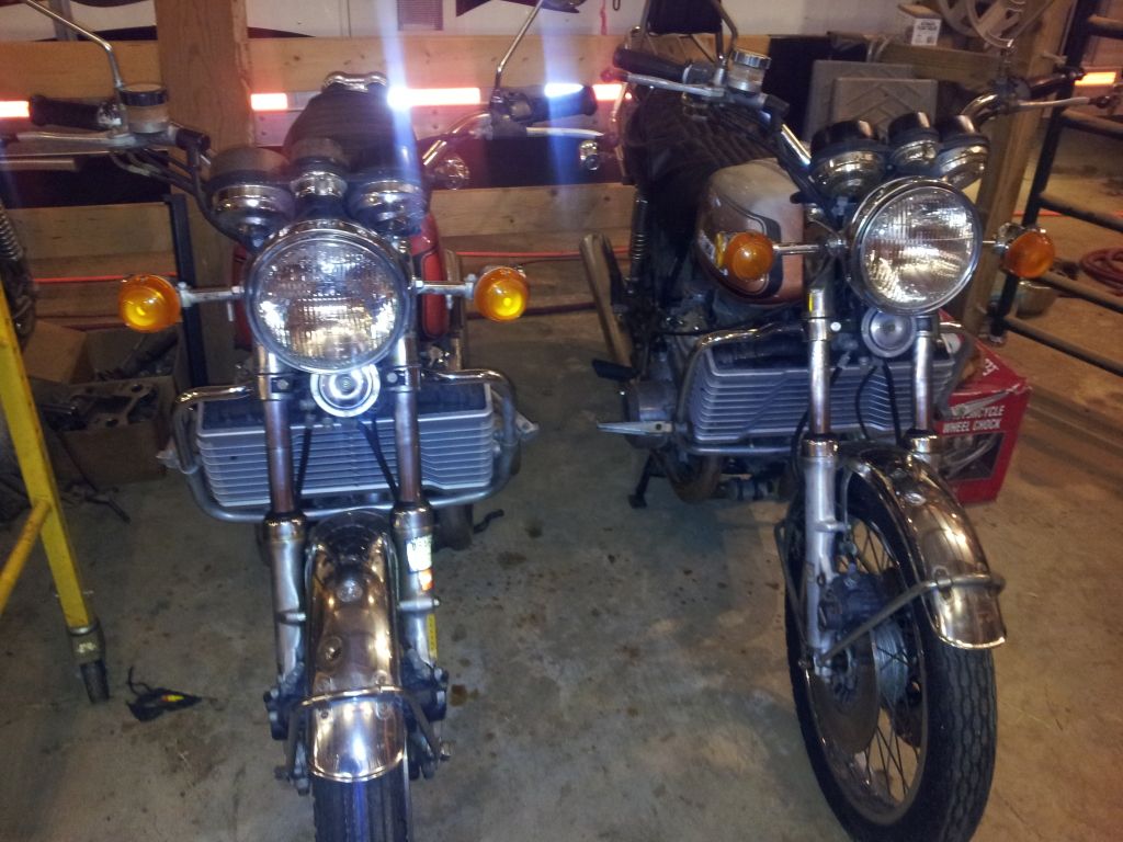

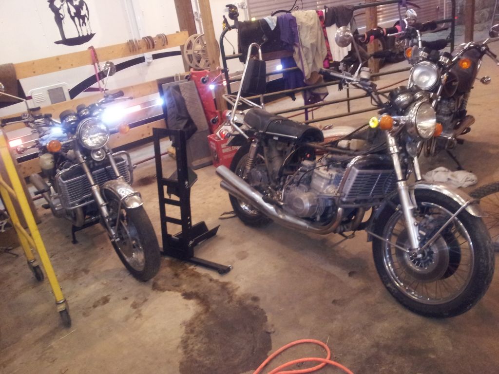

Two days before Barbers Vintage Festival, I bought a 74 GT750 off craigslist with a locked motor. At Barbers I bought another 74, supposedily with bad crank seal(s). Hopefully I can make one good bike out of two bad ones. It will be my first attempt at a GT750, I'm sure I will have to make good use of all the resources here!

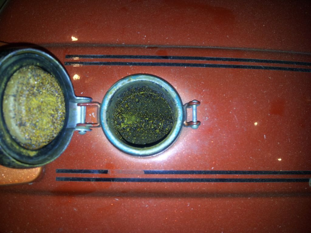

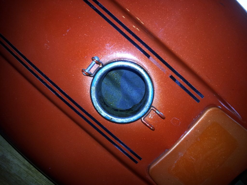

First step is to try and get this thing running. Fuel sys first. I derusted the tank with 36 hrs of 4 gal of vinegar. Turned out pretty well. Only had one petcock between my two bikes, and it was buggered up. Found a rebuildable one on here (Thanks Pearljam!) threw it in the ultrasonic and only need one gasket to finish. Will start on carb cleaning soon, then we'll see if it will run.
