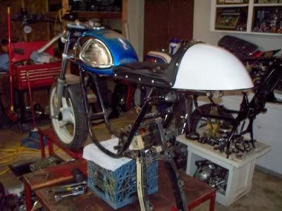

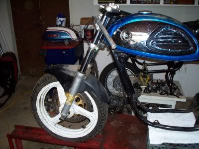

Three different shots as I had started to see what it would look like.

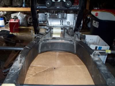

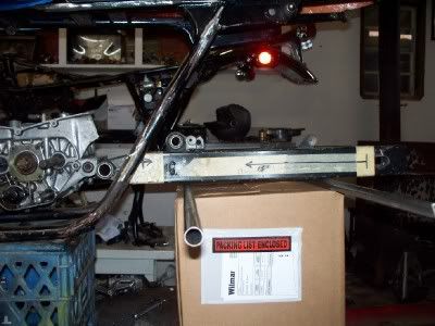

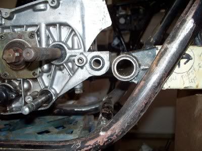

The rear GS500E swinger set in place. The engine was raised in the rear by pivoting it on the front engine mount. This will allow more room for the swingarm and new pivot mount. Also it will allow for less chance of chain bind to the extreeme distance of the CS to the swingarm pivot point.

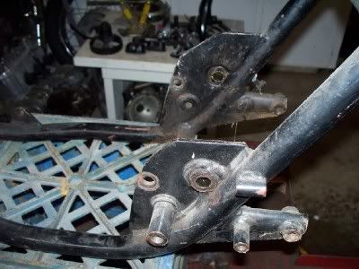

I was going to use the pivot area out of the GS500 but it won't work as the T frame is too narrow. So I am waiting on a few items to be made and will continue with the swingarm.

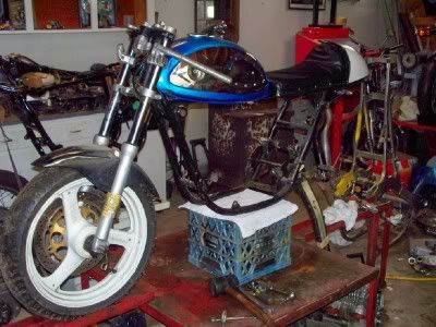

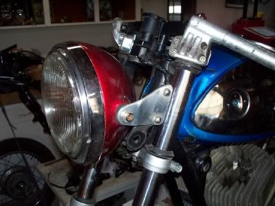

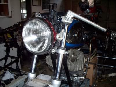

Until then I worked on the headlight. GT750J with GS500 headlight brackets. I will have to shorten the tube mounting bracket so I can lower the bars where I want them to be. The bars are from an 82 GS1000SZ Kantana. The squared bottom headlight I think adds nicely to the vintage scheme.

I like it so far ,
quite an ambitious project to achive by the deals gap deadline.
what is the white and red gas tank in the back of one of your photos from.?.
cheers mark
cheers mark

TZ style tank that was on my former T500 racer. Kept it when I sold the bike. It will be on my next racer.two-stroke-brit wrote:I like it so far ,
cheers mark
