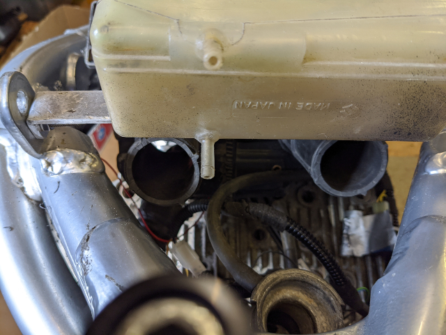

I made a blanking plate for the front of the plastic Triumph air box, cut 2 holes in the section above it for the inlet tubes and re-located the coolant expansion tank.
Everything now fits under the fuel tank and it's front cover, and the fuel tank is such a snug fit that it actually holds the air box onto the carb inlets, so no securing straps or brackets required.
