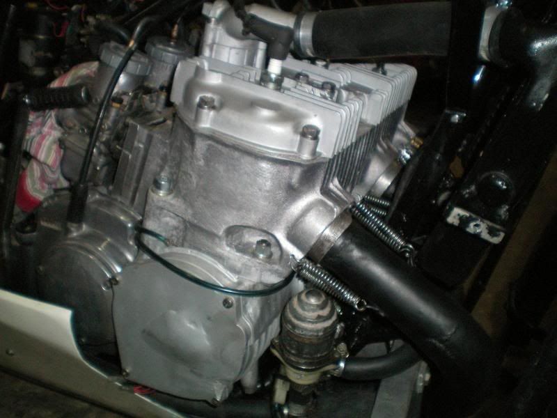

Suzukidave wrote:Hi Shannon .. good stuff seeing the progress on the 1000cc motor . Are you useing a electric or vaccum fuel pump on the 500 ?
fuel pump is an electric from a kawasaki zzr1100 or later zx9.. nothing fancy.
i would use a mikuni crankcase pressure fuel pump but the diaphrams dont like methanol and the current engine in the bike is a genuine TR engine, so i dont want to do any more damage.

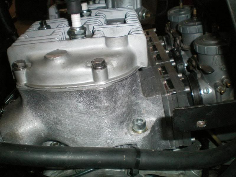

the new barrell will not fit a standard set of cases.. some modest mods are needed to relocate the cylinder bolts.
And Kris. I have seen your bike.. I also have a genuine seeley 750 with a full barton engine with dry clutch.
my frame was also made in 74 , although the tank is a little different. my tank is similar to barry's 73 transatlantic seeley TR but does not have the twin filler caps.

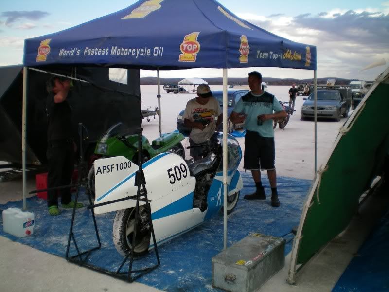

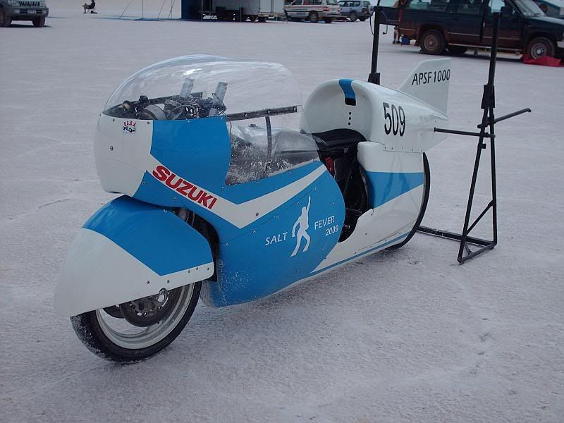

results
Post by shannon »
ok kiddies.. sorry for the delay but my workload,university and weekend womanising has prevented me from sitting down and sorting out pics and stories.
unfortunately we only managed 3 runs for the whole 5 days due to weather and some scrutineering issues with my bike, thus preventing me to achieve a fast enough license pass to enable me to run 200mph + ..
Brett had a 150mph licence and only needed 2 more passes to run the 200 and i needed 4 runs to get up to scratch.
1st run was a 150mph shakedown. 2nd run was a 175mph run and the last run was a 200mph run over the timed mile with and average of 210 and a top speed of 218.
the condition of the salt was poor due to rain, numerous cars with traction issues tearing up the salt and the track length reduced from 7 miles to 5 miles and speeds limited to 250mph.
in current trim and good salt I dare say that 240mph would not be out of the question. its just a shame we wont know for another 12 months. There is talks of bonneville next august..

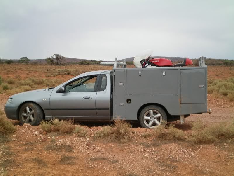

Is the red bike a T500?
Post by Kris Bernstein »
Shannon,
Is the red bike in the attached pictures a T500?
Lovely thing, it is. Who did the frame?
Any chance you'll be casting up some more GT1000 cylinders for customers here in the lower 48???
Kris
shannon
Posts: 20
Joined: Tue Oct 14, 2008 4:21 pm

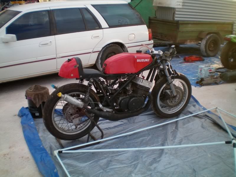

red bike
Post by shannon »
Kris. its a mk4 seeley frame with a full works TR500 engine (#30) with some machined heads from billet aluminium.. she is good for mid 80's hp on methanol...
