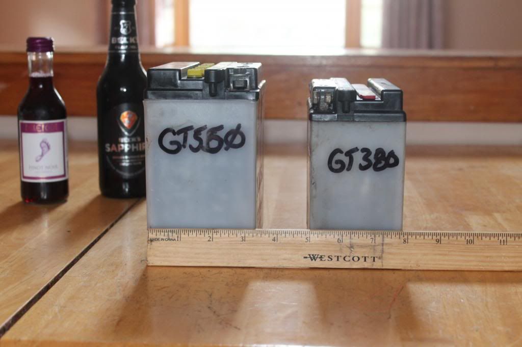

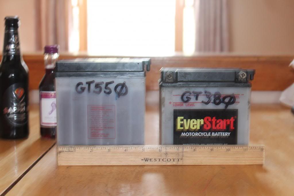

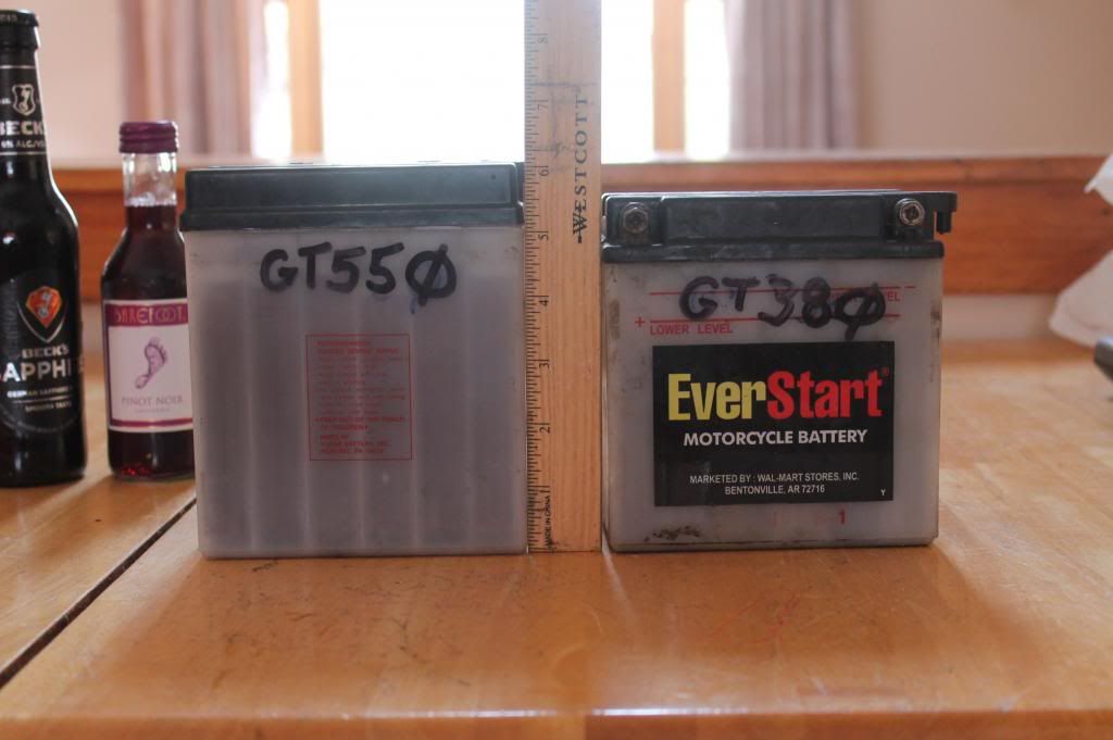

Here's what mine are like
http://i266.photobucket.com/albums/ii25 ... /002-5.jpg" onclick="window.open(this.href);return false;
http://i266.photobucket.com/albums/ii25 ... /006-2.jpg" onclick="window.open(this.href);return false;
http://i266.photobucket.com/albums/ii25 ... /004-6.jpg" onclick="window.open(this.href);return false;

Just had another look after cleaning my specs and realised that the sizes are LxWxH (US site) rather than HxWxL as I would expect 'over here'.Alan H wrote:Yup.ConnerVT wrote:Alan, are you sure you got you LxWxH correct?
They have worked the sizes out a little off on the 550 battery - divide the millimetre sizes be 25.4 for inches, but mine are correct.
Same height, different width/depth.
Mea culpa for not realising.
So the height and depth are different and width is the same as the pics above show.
