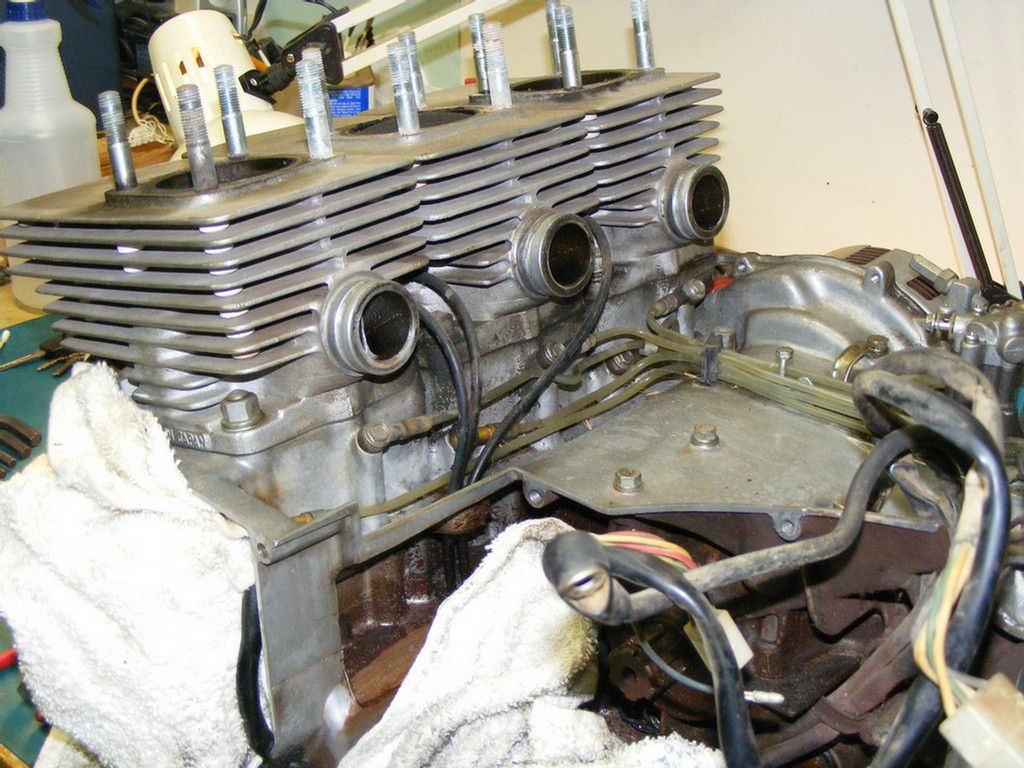

The upper SRIS lines (spigots) are not accessible with the carbs in place. Seeings how the R. Bune was referring to the 750. I assume you are working on your 550. The lines are here:
