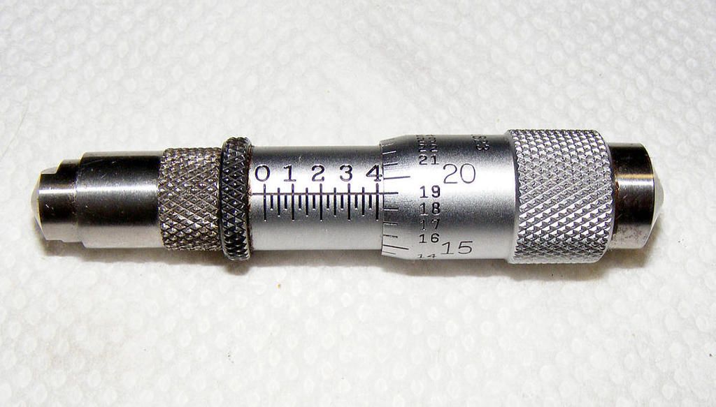

You really need to borrow, rent or steal some inside micrometers and stop just guessing. There is really no other way to tell where you're at. If you need to convert the number is .03937. Example, the stock bore is 61mm. That times .03937 = 2.4015. If your bore checks that plus .002 (2.4035), then bore is stock. If it checks 2.421 plus a couple, it is .5mm oversize. With the micrometers you can also check for out of round a taper. Also steal some 2 - 3 outside micrometers so you can tell what your pistons are.
I am fortunate that I own these tools as I was a machinist for 32+ years. The inside mics come in a set. I can check any size hole from 1 1/2 to 18" in 1/2" increments. I also own outside mics from 0 - 6". My mics in the picture read 2.419..
Image. I have individual outside mics from 0 thru 6". My mics in the picture show 2.419

61.5 is 0.5mm oversize. If you still have the old pistons and rings look at them carefully or measure the pistons and let us know what you find.
