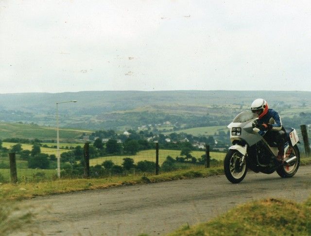

I built a yammagamma around 1998-9 used it daily,Also used it in 1/4 mile sprints.
And i still have it.
