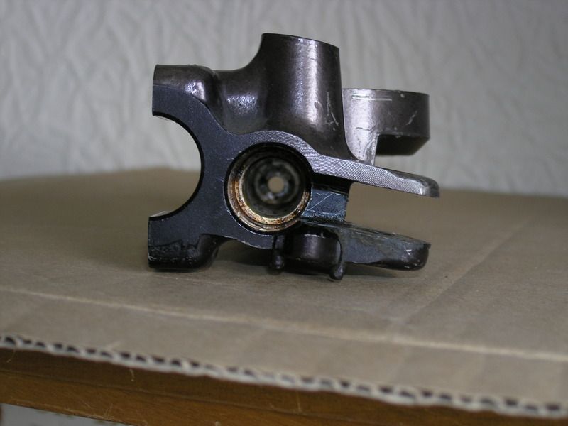

My GT came with the smaller "single disc" master cylinder fitted and I'm wondering if it may be possible to get it bored out rather than search for a replacement. Can anyone confirm the size of the larger MC bore please? I'm presuming it's 5/8".
Also, if anyone has a stripped down "double disc" master cylinder, a photo like the one of mine below would really help :wink:
Cheers, Drew.

.6248 / .6264 Lo and Hi. I used the smaller one on a double disc setup on my 550 cafe. Works like a charm. Even though the MC bore is smaller, that also translates to higher pressure sooner.. I really see no need for the larger bore. Externally, you can't tell one from the other. Ask jabcb how well it stops. He has the bike now. Maybe he will chime in.
There is a sticky post at the top of this section called 'general specs and info'. MC bore and piston sizes are in there.

Just looking at cruzinimages repair kits....my MC is a Tokico one right? Is this the right kit? The seal looks a bit different to mine in the photo.
http://www.ebay.co.uk/itm/75-76-SUZUKI- ... 3a9a553374" onclick="window.open(this.href);return false;" onclick="window.open(this.href);return false;"
Mine:
Re: GT750 Master Cylinder Q
Yes. Asco MC's were not used much before 76. Buy a genuine Suzuki rebuild kit. After all, your life depends on it. Your brakes are not an area where you want to cheap out.
I have rebuilt a couple of these. I don't recognize the tan piece next to the c-ring on the right
