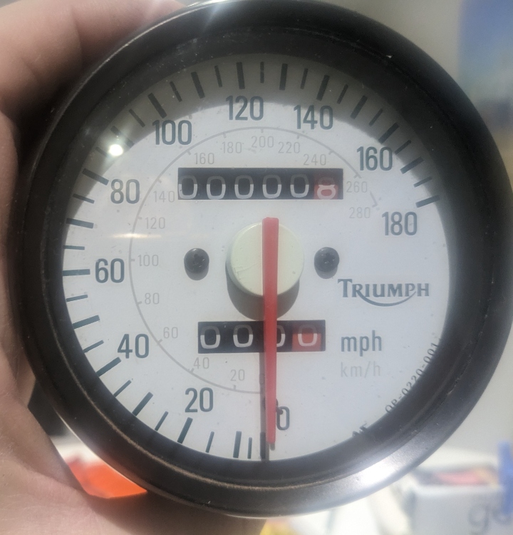

Re: T575 Steam Triple
As it is basically a new bike, I have reset the speedometer to match.
