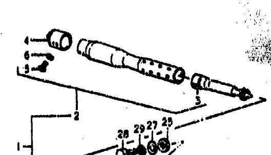

Muffler clean out tube
Post by Admin »
Anyone know what this thing does and if it's necessary?
http://cgi.ebay.com/ebaymotors/ws/eBayI ... 0137315519
Admin
Supreme UFOB
Posts: 34711
Joined: Wed Dec 31, 1969 6:00 pm
Post by Admin »
That would be the baffle for something, can't say fer shur if it's for a TS250, I never removed mine on the one I had, don't know what it looked like. The little pointy end is the spark arrestor.
Admin
Supreme UFOB
Posts: 34711
Post by Admin »
Ahhh...I see. Why is it called a "clean out tube"?
Would lacking one of these make the exhaust loud?
Admin
Supreme UFOB
Posts: 34711
Post by Admin »
It's that last thing in the muffler, and can be removed for cleaning the carbon out. It also quiets the bike a little.
Admin
Supreme UFOB
Posts: 34711
Post by Admin »
I have the two pieces on the left. The clean out tube is on the far right...does it fit inside the middle piece? I'm a little confused here...
Admin
Supreme UFOB
Posts: 34711
Post by Admin »
OK, I guess I had yours backwards. It looks as though it goes in first. The second part probably slips in to it. Not sure.
